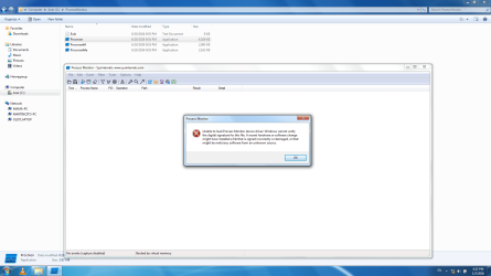

re Procmon ---- possibly the culprit... as its failing and likely retrying

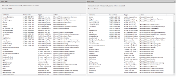

OK, center window in Task Scheduler shows these tasks active. Do any of them looks suspicious? (The one called anti-freeze is my own temp fix for this issue, which is to make the PC restart itself every 24 hours)
As for the running tasks, it was only this three:
No idea what they are.
Where would I find that "re Procmon"?
