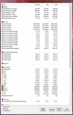

Download and install HWINFO64 (I run Windows 7 Ultimate x64). Open HWINFO, and when prompted, check the Sensor Only option and then run as shown below:
HWINFO will read your system, and then open the Sensor Status panel. Locate the CPU Digital Thermal Sensor items, as shown below:
Take note of the current temperatures when the system is idling, and ensure that there is a differential between the system idle temperature and maximum CPU operating temperature in excess of 20 degrees Celcius - recall that IntelBurnTest will cause your CPU to operate approximately 20 degrees above its idle temperature.
:warn: If your differential is less than 20 degrees, then I recommend not to proceed with running IntelBurnTest.
In my case, I have Max. Temp. 72.6 - Idle Temp. 30 = 40.6 Differential, so its safe for me to run IntelBurnTest.

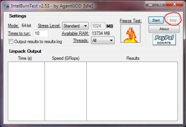

Download IntelBurnTest, and extract the files from the ZIP file into a folder of your choosing. Open IntelBurnTest by double-clicking the executable. You will see the following panel:
Ensure that you familarise yourself with the location of the Stop button, as shown in red above.
Position the IntelBurnTest and HWINFO application windows next to one another in preparation for the tests.

There are 5 Stress Level tests to choose from. I am only going to run Standard, High and the Very High tests. The difference betwen the tests is the amount of RAM available to solve an ever-increasing number of linear equations.
I recommend using the following parameters on the panel:
Time to run : 5
Threads: All

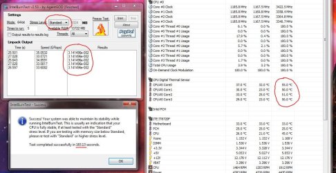

Standard Test:
:info: Time taken to complete : ~3mins
:info: Maximum temperature : 55 degrees Celcius
This is the typical output.
The time for each test is shown. The speed (GFlops) is a measure of the speed at which the equations are solved. In my case, this is about 35 million floating point operations per second. The results is a residual value which is the accuracy to which the equations are solved. A CPU that has passed the test, is one in which the residual values for each individual test is exactly the same.
A Success panel is also shown to confirm the CPU is stable under those test conditions. Note that the maximum temperature attained is 55 degrees Celcius - still well below my TCase temperature of 72.6.

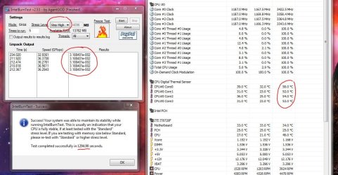

Very High Test:
:info: Time taken to complete : ~21mins
:info: Maximum temperature : 58 degrees Celcius

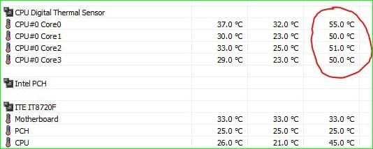

dude, you´ve made a mistake. core temp is not tcase.
Dude....where do you see the words "core temp"?
Golden Mk. I.4
EVGA NVidia GTX 560 1024MB
Realtek Integrated
1920*1080 and 1920*1080
1*Samsung 840 EVO 120GB SSD;
1*OCZ Vertex 2 60GB SSD;
1*Samsung F1 SpinPoint 1TB;
Logitech G110
Logitech MX518
the CPU DTS values (core 0, core 1, core 2, core 3) in hwinfo is not showing you the tcase temp. aren´t you referring to the core temps shown in hwinfo?
the tcase temp can be found under the ITE 82720F record in hwinfo or am i missing something here?
Yes this refers to core temp, the DTS, Digital Thermal Sensor per Intel specs reads the temp at the geometric center of the IHS, Integrated Heat Spreader and it the temp monitored during the IBT runs. Tcase is generally 10C-15C lower.
