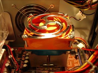

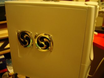

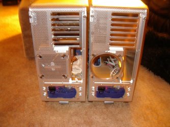

Juan, if cost is prohibitive, there are case/fan mods you can do.
I realise the pics i am posting are not of the same case, but it's to give you food for thought.
These are some i have done over the years.
Put a bigger fan on the heatsink, by using an adaptor.
Cut the grating out for better airflow.
Cut some holes in the side cover and added a couple of fans.
