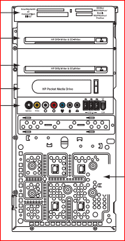

As for cutting a hole in the front, this is the best I can find for what it looks like behind the front panel (from the service manual),
As for cutting a hole in the front you would need,
1. A Dremel or some other cutting tool to cut the hole
2. A drill for drilling mounting holes for the fan
3. Remove the floppy drive or figure out some other place to put the hard drive after cutting a hole
4. Take everything out of the case as motherboards and what not don't react well to metal filings in them

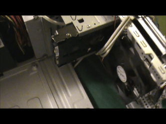

Best pic of the mounted hard drive and front fan I could get at this time i have video but is to big and not allowed for attachment.

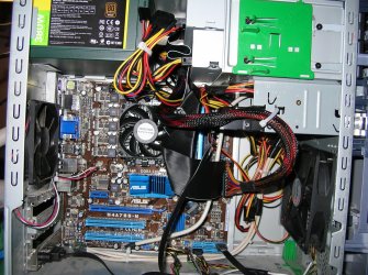

Custom side fan in case, plus moved middle lower fan to the front of hard drives , also installed a second intake fan in lower two optical drive slots. Rear fans are controlled by Fan mate controllers. temps inside case are monitored by probe and temps coming out the top exhaust are also monitored, temps as of right now 20c inside and 22.7 out the exhaust. Front intake fans are controlled by Asu
Wow looks good, how does it look from outside with everything on its place ?

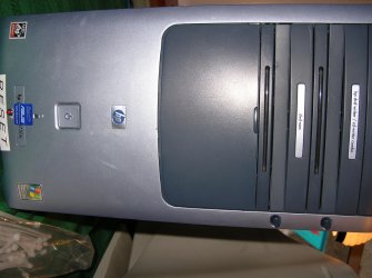

More pic of another build same mounting with a picture of the front of the case with the reset button clearly labeled for the not so savvy computer family. Triple core unlocked into a Quad core with the new motherboard and Hyper-X ram which is hide in the wiring which after first startup I arranged a little better.
