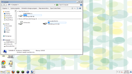

The D drive (partition) is missing, no wireless, no disk management, the theme is messed up, and this happened overnight when booting it up.
Windows 7, Home premium, 64 bit.
Ideas?

First install and run a full scan with Malwarebytes to see if you have an infection which could affect recovery. If this is a problem download and burn to CD or write to flash stick, boot and run a full scan with Windows Defender Offline
If the partition is missing you can often recover it by booting free Partition Wizard Partition Recovery Wizard - Video Help. Post back a camera snap of the drive map and listings if possible.
As suggested try to System Restore.
Well, I have recovered D, but everything else, (Wireless, system restore, windows theme, taskbar) Is still the same. Any other ideas?

I've fixed the problem by going into Advanced Boot Options - Fix your computer - System restore. System restore worked by doing so.
