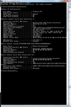

I have been having this problem where my internet cuts. When I troubleshoot using windows troubleshooter it says that "Default Gateway is not available". Now i know its not my router because other devices work fine. My PC is connected via Ethernet and other Ethernet devices work fine. My NIC is "Realtek PCIe GBE Family Controller" its currently up to date on the driver. Ive tried "ipconfig /release + ipconfig /renew " as well as "netsh int ip reset resetlog.txt" If i disable the the device and enable it again it will work briefly before having the same problem. I can't seem to figure out the problem. I'm hoping someone will be able to help. I will include screenshot of my ipconfig /all during the problem.
Thanks,
-Thrashix

Your IP configuration looks fine to me, Have you tried using a different port on your router? Also, have you tried using a different cable? I have a feeling that this may be a physical issue.
If you can, please test on a different network (Possibly a friend or relatives?) as it can help determine if there is an issue with a cable or a particular port.
Many Thanks,
Josh :)
