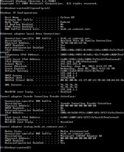

So, I've been encountering this problem for a LONG time. even after I wipe my hard drive and re-install everything, update drivers, etc. I cannot get it to go away. The issue is basically that every hour to a few minutes my internet will go to "limited to no connectivity" then when I use the diagnostics tool it tells me "Default Gateway not found: Fixed" but then the problem comes back. I've searched everywhere for a fix and tried about everything. Tell me what I need to do to try to get this problem resolved. (I'm a little bit uneducated about computers so step by step instructions would help) Also, I am connected by cable.

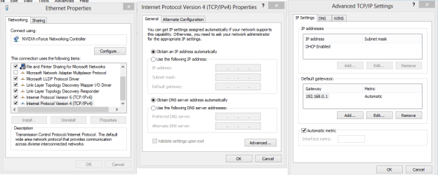

Looks to me like someone typed in the DNS and probably a few other things into the IPv4 and IPv6 properties which aren't really required when using DHCP. You should try removing all info typed into the IPv4/IPv6 properties and leave it at DHCP enabled on IPv4 only.
For the gateway problem it can sometimes help to type the default gateway manually into the IPv4 properties, right click on the network adaptor and choose properties then click on IPv4 then choose properties again, click the advanced tab then click the "add" button and type in your default gateway >192.168.0.1, hit apply, ok etc., this will sometimes fix the problem with the gateway dropping out.

I tried this and it worked for a night, then it cut out again the next day. but now it cuts out a lot less frequently. Anything else that might help?
EDIT: I just noticed that the change reverted itself over night for some reason, reapplying it, we'll see if it works.

Hitting the Apply then Ok button should hold the settings. Updating the driver might also help.

So, it seems that every time I turn off my computer the change reverts itself, but when I put in the gateway again, I don't disconnect at all. I don't know why the changes aren't saving, Im turning my computer off normally and everything.

Try running this IPReset .exe file, it will reset everything IP related and flush the DNS cache, it will also reboot your machine automatically. After rebooting please post the ipconfig/all again as there were some anomalies there.

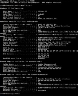

Sorry for the late response, I've been gone for a while, but here it is, I did what you said.

OK I'm starting to get an idea of what's going on here. What I'm seeing is two different default IP's, this usually means that what you think is just a modem is actually a modem/router then it appears as if you are plugging that into another router with a different default gateway.
In order to confirm this I need to know the model number and name of the modem you are using, I also need the model number of the router you are using.
This is a very common problem and isn't so easily diagnosed, you would usually just need to turn off DHCP on the secondary router and plug the cable from the modem/router into the LAN port on the secondary router. Although there may be a bit more set up involved depending on a few different factors.

Well it's just a regular modem so something else is causing the problem. I'm seeing DNS entries in the IPv4 properties that don't need to be there as the router should be handling DNS, best to just type the DNS servers into the routers settings for DNS.
Which default gateway are you typing in? It looks like you need to use 192.168.1.1 but I see another gateway of 192.168.0.1?

I just changed it to 192.168.1.1 I noticed that now that you said it too, I'll report back if that fixes it
