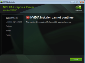

Thanks for the response.
I just tried doing that however I get this error: "The graphics driver could not find compatible graphics hardware" before I am even given the install option.
I attached a picture of what I see.

Do you have Windows 7 32-bit or Windows 7 64-bit?
Obviously you'll need a 32-bit driver for the former and a 64-bit driver for the latter.

Windows 7 64-bit.
I have tried the detection utility but I receive this message: "Unfortunately we were unable to detect your GPU. Please try again using the manual search"
Are you absolutely sure you have the GTX 560 installed in your computer, because right now I'm out of ideas.

I'm sure =/
I was using it before I restored
Solved by editing the .inf files in the Dell driver instead of the nvidia driver.
Thanks.
