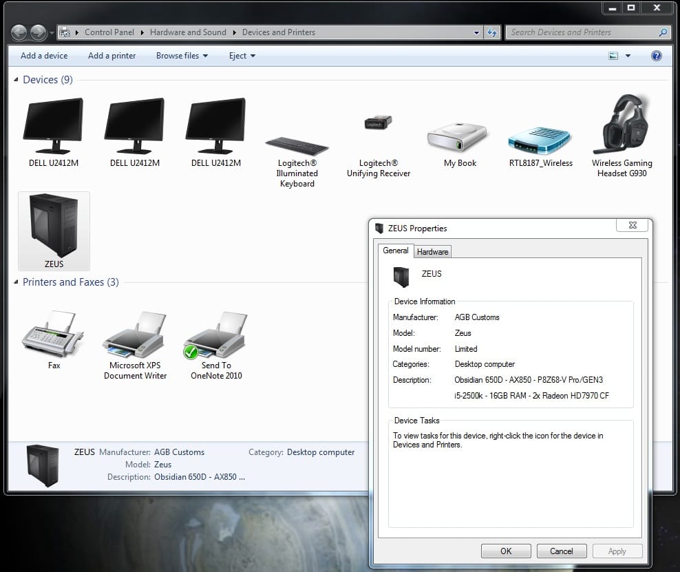

This tutorial will cover how to change the icons in Devices and Printers with a custom icon of your choosing and be device specific, eliminating resource hacking and/or overwriting Windows 7 default icons.

Final Example: Custom Computer Icon
