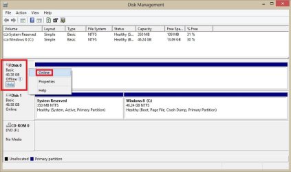

6. If the status of the selected disk # (ex: Disk 3) shows as Offline, type online disk, and press Enter to make it online. (see screenshot below)

Right click on the Disk # box on the left side in the bottom middle pane, and see if you have on option to set it to be online like below. Afterwards, see if you are able to create a new partition on the unallocated disk. :)
