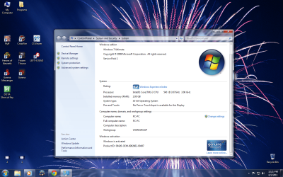

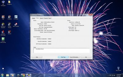

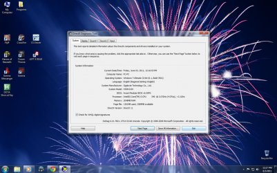

Ok, I uninstalled my drivers and downloaded the latest ones but none seems to remove the error. My screen is sometimes getting pixelated and distorted in weird ways even when I'm not doing anything that heavy to my system. Can't play cause everything gets pixelated and sometimes causes my computer to hang up. And then it pops up again, any more help? :(
Windows 7 Ultimate 32-bit
well some system specs would be helpful
by the sound of your issue graphics card might be playing out if it is onboard then something is going on with the chipset
sorry about the above you posted specs but didnt see what kind of graphics card ?
