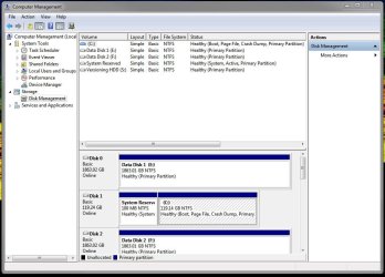

Here 'tis::

Hi Jeannie
Disk management shows no evidence of a UEFI install or system. So if yours is EFI then it must be set to CSM or Legacy BIOS. In some minimal BIOS this will only be determined by whether the installation media is booted as a UEFI or Legacy Device.
When UEFI was in its infancy we often needed to encourage users to install to legacy if there was no firmware update that enables a UEFI install of Windows 7. However gradually the manufacturers caught up and now this has not been necessary in about a years time. So I recommend in most cases doing a UEFI install to experience the full features of the new generation of BIOS.

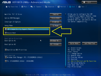

If you have an old Asus motherboard, then there are no CSM and Secure Boot settings and then you won't be able to install Windows 7/8/10 in UEFI boot mode.
The Asus motherboard CSM and Secure Boot settings. -> link
Here is info about UEFI Boot Mode (installing using the GPT partition style) and Legacy BIOS Boot Mode (installing using the MBR partition style): link
