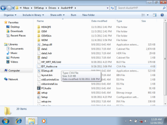

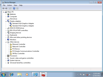

Hello all I really need help with this situation please.
I just now downgraded to windows 7 ultimate x64 from windows 8 pro x64 now the problem is I cant install any driver, I did a clean installation formatted primary partition of windows 8 and installed windows 7 ultimate. What to do now please when I go to driver folder I downloaded from hp support drivers the pc cant read the cva file of installation and im stuck with it no nothing can be installed whenever I press on it I get the open with option, I cant connect to internet wireless or with cable ive attached some pictures I hope someone help me. I did a clean installation thrice and same problem
My laptop is HP pavilion g6 1320se which came with windows 7 and supports windows 8 too I got tired of windows 8 and decided to downgrade and this what happened

mezo91, you need to install your network drivers for your card. Go to the HP site (from a different PC) and download the network drivers for your notebook model and save the files to a USB flash drive.
Once you have this, copy/extract the file you downloaded of the USB drive to your newly installed Windows 7 PC, open Device Manager and expand the "Other Devices" section in Device Manager, right click the entry called "Network Controller", select "Update Driver" and point the wizard towards the file you extracted to find the drivers. This means you will need to select "Browse My Computer for Driver Software" and specify the path to the folder.
If all you have is "setup.exe" or "install.msi" in the file you extracted or if no drivers are found in the step above, run that. Once you have your network drivers installed, you can tell Windows to search for the rest of your drivers online. By right clicking every device in the "Other Devices" section and selecting "Update Driver". If no suitable driver is found, you will need to rely on the manufacturer's website for drivers.

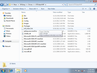

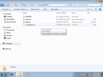

When I go to driver folder I downloaded from hp support drivers the pc cant read the cva file of installation and im stuck with it no nothing can be installed whenever I press on it I get the open with option,
Look for a Setup.exe file in that same folder and run that. If there is no Setup.exe file you likely downloaded the wrong file, program or application. Google refers to a CVA file as a Compaq Diagnostics file.

Thanx all guys, the problem was in the swsetup sources norton 360 removed some files so I couldn't install drivers software correctly. Had to download them all again from scratch.
