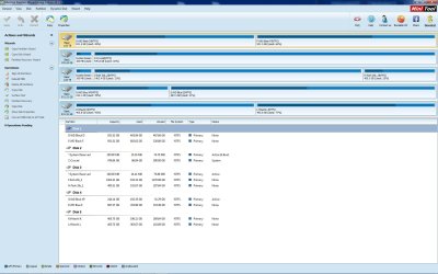

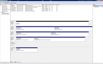

The drive in question: WDC WD1002FAEX-00Z3A0
I am waiting for Testdisk to finish its deepscan so uploading attachements of Diskmanagment and current scan for now.

Hello Louiscar!
So you are using an internal 3.5'' WD drive in an external enclosure? Is this enclosure a simple USB 3.0 connected or does it use external power too? GokAy, this seems to be a DIY external drive, so encryption is unlikely. But you are right, OP should try all the actions with the drive from within the enclosure.
It is possible that during power ons and offs the partition table became corrupted; usually Partition Wizard is the best case to go. Could you give a bit more detail to what you were doing or what was happening with the drive when this happened?
But most times recovering the partition is a bit too hard and there is the chance that the more you meddle with it, trying to recover the partition, the more this damages the drive and the data may become unrecoverable.
I understand you want to recover the partition out of greater convenience but do firstly transfer as much as you can, since you said there were 9000 files found.
If nothing works, you're left with the option of a professional Data Recovery.

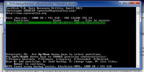

Aha! As I was typing this - Testdisk finished its scan and it appears to have found a partition. As I've not used it before I am not sure of the next step but this looks kind of hopeful!

Edit: Grr! I pressed return to look at the partition then backed out and it went to the analyse screen. Have to start the scan all over. I guess the answer is to press 'write' but if it's better to use another tool please advise - at least the partition shows up on a deepscan which I never did with Partition wizard or Easus. I am not sure what's the best / most reliable tool to use although I understand that you guys here tend to recommend Partition Wizard?
Note: I didn't get a directory listing when I pressed return which is not a good sign:

Yes it is a double. I thought I might have maybe not pulled the drawer out enough or it perhaps got knocked in enough to lightly make contact. Unlikely but I'm clutching at straws right now.
REgarding TestDisk and looking at the screen grab vs article.
I had
* HPFS - NTFS
As per the first line with no other partition listings so I might not be able to recover from this as the article uses the other partitions marked
D HPFS - NTFS
after confirming that folders are listed. If I recover the only listed partition it may not work as I expect. Not sure

NTFS found using backup sector. Block size 4096. How?
Your enclosure seems to have done some funny things.
Please do not give any write command for now.
What other drive do you have in the enclosure? Is it functioning OK?

Edit: I see what you mean.
Is this relevant?
cgsecurity.org ? View topic - Filesystem corrupted, partition OK

.... and here we are with the hitachi external showing.
Windows 7 ultimate 64biti7 92012GBMSI R7
Home Brew
i7 920
Asus P6 Deluxe
12GB
MSI R7
Crucial M550 512GB SSD
WD 2TB Black
WD 1TB Black
WD 1TB Blue
Toshiba 2TB
Hitachi 1TB
HAF 960
Corsair H80 Water
OK, you are using PW old version 8.1.1. If you install the new version it will show whether the drive is MBR or GPT in the Disk Map. Please install the newest version. That shouldn't take much time.
For now right click on the partition K: Hitachi K > Properties > File System info and tell me whether it is 512 or 4096. If in doubt post a screenshot.
I would prefer to see the screenshot taken with the latest version of PW.
I need to tell you again that it is going to be a slow process and in addition due to time zone difference we may need to take a break and continue only the next day. I have another two hours before I retire for the day. We shall do as much as we can in that time and thereafter continue tomorrow.
Your HDD is in good health and so no need to worry about time.
