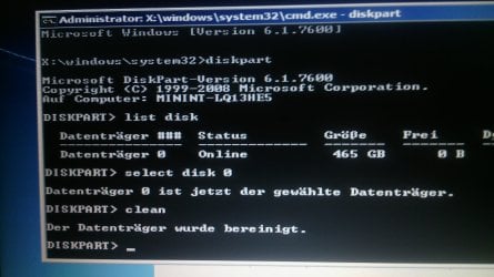

hello g-rock,
thank you for reply. ok, i went ahead with your instruction of drive wipe as per the link you provided. there are however, a couple of things that i could use your help or clarification on, please:
1) when i bring up command prompt, instead of c:\windows\system32>....., i get x:\windows\system32>...
is this ok? if i am not mistaken, x:\ is for the recovery drive? am i still on the right path? (see attached picture)
2) disk 0, the only disk available shown (which should be correct, because there is only c:\ on the notebook), shows free space of 0 bytes. is this correct? is it that it shows this (possibly) because during the attempted clean install of c:\ previously, the drive was being reformatted, and since for some unknown reason, the notebook shut down, therefore the drive was not properly/fully formatted, resulting in 0 available space?
3) according to the instructions in the link, after i do a "clean" or a "clean all", i have to create a new partition or volume, again going back to command prompt to do this, is this correct?
sorry for so many questions. thank you for indulging me.. :confused: and my ignorance. :D

I cannot translate the results of Diskpart shown but if it says the disk was cleaned then proceed with the commands as obviously they are working.
