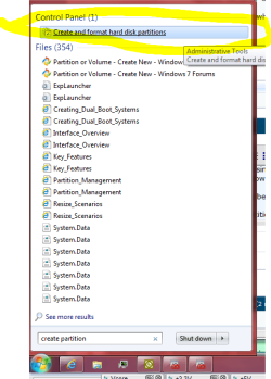

Go to Start and type "create partition" in search bar. Click "Create a Partion".
This will open Disk Management. My second Snip.
You will only show two hard drives if it is showing properly.

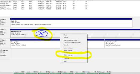

This should erase info on Disk and format.
On the storage hard drive right click where I made the blue X with circle.
Do this on storage drive not the OS!!!
Then click Delete Volume in the pop up window I circled in yellow.
I am making Snips and posting as I do it on mine so this may take a few minutes for everything.

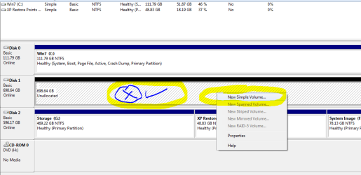

Left top Snip below.
Now the drive will show Unallocated.

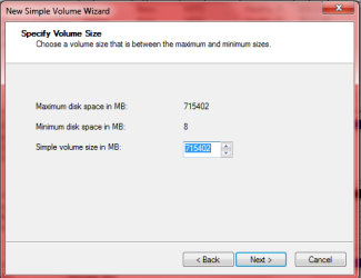

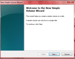

Right click where I marked the blue x again then click New Simple Volume.
Top middle Snip click next, Top right click Next and all of the windows click "NEXT".
I think there were 4 total to click NEXT.
Then bottom left SNIP will show. It should say as mine Healthy Primary.
Hopefully after all this it will show in Windows Backup. ;)
Let us know if it works or not and we will go from there.

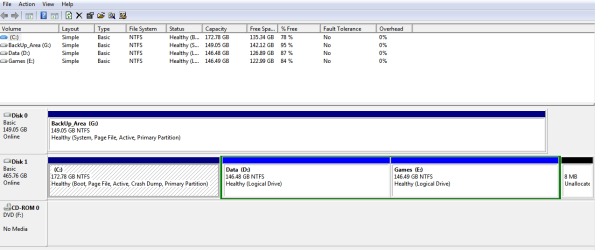

^^ On the storage drive, the Delete Volume option is disabled :(
This is how my disks look. The G: is the storage drive

I believe that has something to do with it being marked active, also your statement here,
I had XP installed on the 2nd drive earlier, and so I think Windows Backup does not show it as it identifies some system-critical files on it
And this,
I have formatted the 2nd drive, but still no luck.
I also tried the Disk Wiper tool in CCleaner to erase all hidden files in the drive, but that takes ages to wipe the disk.
I'm not sure you did that successfully, looking at your disk management window.
And since it still shows almost 7gb still on that drive as well.
The fact that is the first disk listed might be a problem as well.
Win 10 Pro x64
Intel I5-2500K @3.3GHz
Asrock P67 Extreme4
EVGA GeForce 750 Ti SC 2GB
auria eq2367
250GB Samsung 850 EVO SSD
1TB WD Blue
1TB Hitachi
SeaSonic X 650W 80 Plus Gold
Corsair Obsidian 750D
Logitech Wireless Mouse M310
Wave Broadband ~ 100 dn 5 up
Edge, IE11, Chrome
Laptop specs: HP g7-1365dx /
RAM: Crucial 8Gb (2x4Gb) /
GFX: AMD Radeon HD 6520G /
OS: Windows 10 Pro x64
I think the problem lies as it says G: is a 'System' drive.
I guess Windows 7 boot critical files might be present on the G: instead of C:
I fear this because when installing Windows 7, I had the G: connected.
Can this be possible? that Windows 7 is installed on C: but the boot critical files are stored in G: ? :huh:
If yes, I think I would need to do a complete format of G: before the OS loads. How to do that?
And if no, then what could be the other cause? and its fix?

You got it meetdenis.
System should be with Boot. As mine is below.

You can install the OS to your "C" and leave the partitions -or- wipe the entire drive and start from scratch. If you do that do not make the extra partitions logical. It isn't necessary if you have only 4 partitions and you cannot change them back to "Primary" without losing your data on the Logical partition..
This will get you thru deleting partion if needed.
http://www.sevenforums.com/tutorials/2668-partition-volume-delete.html
Extend volume- put the partitioned areas back together. Just in case.
http://www.sevenforums.com/tutorials/2670-partition-volume-extend.html
Create volume or parttion.
http://www.sevenforums.com/tutorials/2674-partition-volume-create-new.html
