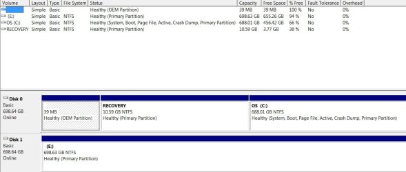

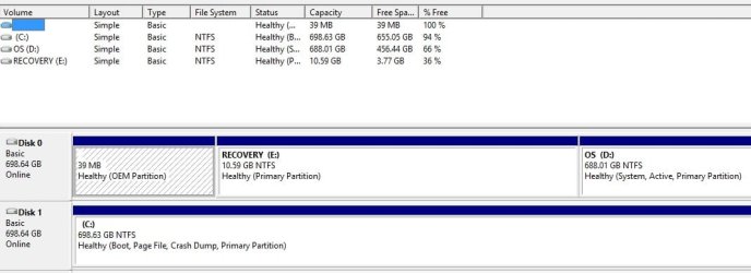

With W7 set as my default OS, first screen is from W7 and the second from W10TP.

Is that the original factory install for HP or Dell? That's the worst possible install of 7 one can have. It would possibly have been booted by Recovery which could have caused problems when installing 10 with it connected. Did you move the System partition to C by marking itActive to run 3 Startup Repairs or another method?
This is another reason why its best to unplug the other HD when installing anotherOS lest it merely Update the boot files on the old System partition making the new OS dependent upon it to boot.
You can reinstall 10 correctly or try marking it Active to run Automatic Repair with 7 drive unplugged. If this fails you will need to use more advanced methods possibly known at EightForums since they are its specialists.
Either way once 8 is System Active and boots itself if you don't like booting Secondary via BIOS Boot Menu keyyou can install EasyBCD to add the other from your choice of Primary Drives set first to boot, getting the Boot Menu you prefer. The drives will remain independently bootable.
