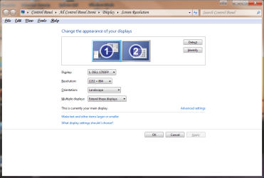

You should connect both monitors to the ATI Radeon HD 4600 series card that you have, one in the DVI and the other in the VGA port. As far as converting, you can use a DVI to VGA or vice versa. Then on your desktop, right-click somewhere on it and select "Screen Resolution" and then click on "Detect" so it can see both of your monitors. Once it shows both displays, you can select next to Multiple Displays to either extend your desktop.
Alternatively you could do this through the Catalyst Control Center by launching it (CCC) and then going under "Creating and arranging desktops" and then click on "Detect Displays" and it should detect both displays after that. You can then click on "Apply" and arrange them right to left or vice versa.
And with today's modern video cards, you do not need two video cards to be able to use 2 monitors.
