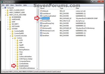

3. In regedit, navigate to the location below, then do step 4 or 5 below. (see screenshots below step 4A or 5A below)
HKEY_LOCAL_MACHINE\SYSTEM\CurrentControlSet\Control\CrashControl

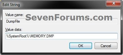

A) In the right pane of CrashControl, double click on DumpFile to modify it. (see screenshot below)
B) Type in the full path in the "Dump file" field that you would like to have the MEMORY.DMP file saved at with MEMORY.DMP still at the end of the path, and click on OK. (see screenshot below)
NOTE: The default path is C:\Windows\MEMORY.DMP or %SystemRoot%\MEMORY.DMP.
For Example: If I wanted to change the default location to C:\Users\Public, I would type this location below.
C:\Users\Public\MEMORY.DMP
C) Go to step 6.

A) In the right pane of CrashControl, double click on MinidumpDir to modify it. (see screenshot below)

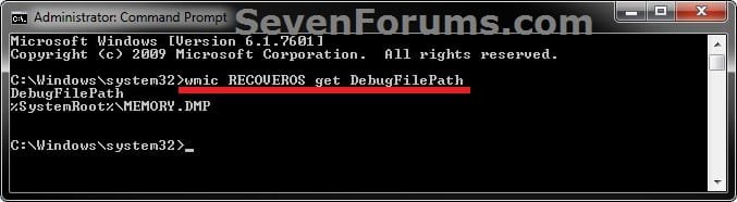

2. To See What the Current Default Dump File Location is Set To
A) In the elevated command prompt, copy and paste the command below and press Enter. (see screenshot below)
wmic RECOVEROS get DebugFilePath

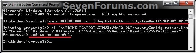

3. To Change the Default Dump File Location
A) In the elevated command prompt, type the command below and press Enter. (see screenshot below)
wmic RECOVEROS set DebugFilePath = "file path"
   Note
Substitute file path in the command above with the full path within quotes that you would like to have the Minidump or MEMORY.DMP file saved at with Minidump or MEMORY.DMP still at the end of the path.
Minidump = Small memory dump
MEMORY.DMP = Kernal and Complete memory dump
4. Close the elevated command prompt.
