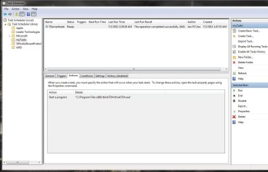

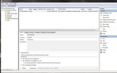

For some reason I cannot get this to work. I followed the instructions diligently and retried it numerous time to ensure I was not making a simple mistake. However, when I click on the shortcut created I see a CMD prompt box open and close very quickly and then nothing happens. If I go to the task scheduler and simply click run on the task it opens the program. However, that is the only way to get it open, the shortcut will not do it. Can anyone look at my xml script to see if I made any errors
Dell XPS 8100
Windows 7 64 bit
Intel Core i5 650
6 GB RAM
Hello Joe,
Could you post screenshots of the task fully displayed with all settings in Task Scheduler to see if something may stand out?
Let me know if you need anymore besides these two...ThanksCapture1.JPGCapture2.JPG
Dell XPS 8100
Windows 7 64 bit
Intel Core i5 650
6 GB RAM
Ah, ok. I see the problem. You didn't create your task inside the actual Task Scheduler Library folder like displayed in step 2 and 10, but created the task in your new myTasks folder instead.
Since you have it in the myTasks folder instead, you would want to use this target location below for the shortcut instead to indicate the the TDameritrade task is in the myTasks folder instead of the default Task Scheduler Library folder. :)
%windir%\System32\schtasks.exe /run /tn myTasks\TDameritrade
