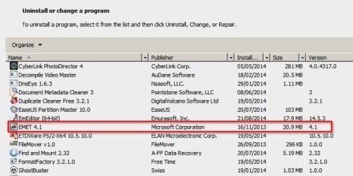

Have a look for an entry like this. The version number might be different.
EDIT: If you don't see it then it's not installed. If you think that it's somehow still running - install it again then remove it. See the post below this one.

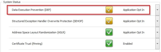

However check your settings as I reckon that you need to configure as shown here:
Then manually add apps as shown above when you install them.

No, not running in the background but modified system settings that still exist after removing EMET. See if you have an EMET icon in the systray, a gray/black lock. See my avatar picture for example.
EMET disables the DEP settings from System Properties so you can't change it anymore. Instead it's controlled by the system wide settings in EMET. You could try installing EMET again and change profile to the Recommended security setting. Recommended settings is probably "Opt In" x 3. Reboot and then uninstall EMET.

Not really. EMET could still show up in your recent items, but still be uninstalled.
If EMET isn't listed in your Programs and Features like Callender posted above, then EMET is not installed.
