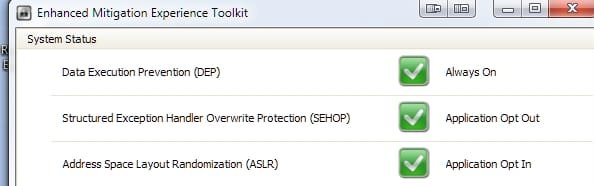

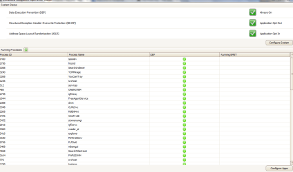

I repaired it and it worked..By the way why are all my processes being monitored by DEP instead of EMET?

DEP is the default, bagavan. If you want them to also be monitored by EMET, you'll have to add them by clicking on the "Configure Apps" button.

can I use EMET to monitor all the processes?

Sure, though I doubt it's necessary. Watch the video linked to in the link in Brink's initial post. :)

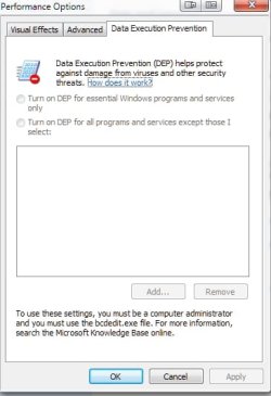

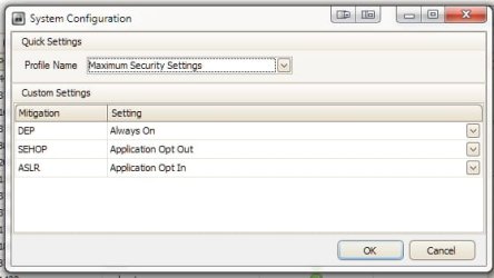

My DEP remains on and runs in conjunction with EMET (actually, EMET replaces DEP as Brink said):
EDIT!!!!:
After setting EMET to "Maximum Security Settings", as Brink advised:
And a reboot, I do get the message regarding DEP Brink showed:
However, EMET still shows DEP as being active and not disabled:
Sorry, Brink, still sorting this out. I should have read your post more thoroughly. EMET is DEP with extras. :)

If you install EMET and "Configure System" settings to Maximum, it will gray out the default DEP settings since EMET will be used instead
FYI
It didn't do this on restart
Set on Maximum internet access would not function.
MSE and Avast both red X'ed and would not turn on.
Windows Internet troubleshooter stated I had access but the internet icon was red X'ed and no access was allowed though Outlook or IE9.
So I set EMET to recommended instead of MAX., restarted and everything works again.
I don't know what kind or amount of protection I have on recommended.???
Posted this for others if they have similar or same problem.

Hello Mike,
That is strange. It allowed those to work for me automatically using Maximum. I don't have Avast installed anymore though since I'm only using MSE. You might uninstall Avast as a test to see if it may help any.
Did you try clicking on Cinfigure Apps at the bottom to see if manually adding the exe for these and checking them there may help?
