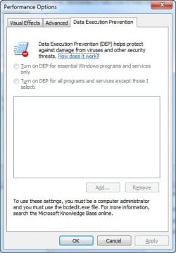

my DEP is all greyed out,
i have several programs that have stopped working, i installed a racing game and it didnt work properly, searching the net for answers found many references to turning OFF DEP, so i did. the racing game still didnt work and has since been uninstalled, but now i'm left with my current problem,
will installing EMET re-activate DEP and get these previously working program working again
thanks.

Hello Angus, :)
If you have EMET installed, then it's normal for DEP to be grayed out like this.
You would need to add the exceptions in EMET instead of DEP now.

thanks for the reply Brink, i dont have EMET installed but the DEP feature is still greyed out for me .
will install EMET 4.0 shortly

Ok. I'd recommend to use the default settings for EMET. Please let us know how it went. :)
a friend recommended i do a full virus scan and see what happens after that, so i did........32.5 hrs and approx 15 million files later, it was done
i checked the DEP box and it was still greyed out, so i opened up the Command Prompt as an Administrator and typed....
DEP - Enable or Disable
bcdedit.exe /set {current} nx AlwaysOn
no luck, still greyed out
then i found this
bcdedit.exe /set nx OptIn
so i typed that in in the same way, as Administrator, rebooted the pc and woohoo, it was active. so i went to my desktop and opened all the programs that were inactive and success, they all worked as they should
so i'm all good at this point.
