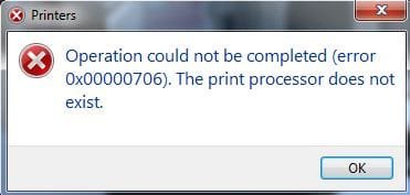

when we install the driver the software says u must install the printer cable then it will install and detect the port but there is one more option manually i did that but it gave an error im attaching the error file here..thx for help sir :)

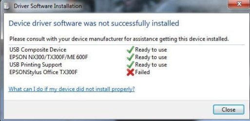

after that i removed all the drivers from add remove so that windows 7 automatically detects the driver,it did but the main print driver it failed im attaching that file too
the first file is of manually wich i did the second file is windows 7 automatically detect when i installed the usb cable it installed 3 drivers but the print one it shows fail.....
