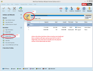

Alain mate as it is 4 + years old then it is a fair bet the drive is reasonably "well used" you could try the surface test with Partition Wizard too it isa physical test as opposed to a contents test.
Best Free Partition Manager Freeware and free partition magic for Windows 7, Windows 8, Windows Vista and Windows XP 32 bit & 64 bit. MiniTool Free Partition Manager Software Home Edition. < very handy tool to keep I use it all the time.
See my pic for how it runs and looks.

I've downloaded Partition Wizard, and it's currently running. However, it's basically the same as an error scan in HDTune, and my scanning speed is less than 2mb/sec.. Which means it takes more than 20 hours to go through 2TB... Not really viable. I have done a quick scan in HDTune, which gave me 1 bad cluster. I'm letting the test run regardless, hope that it gives me some extra indications.
Yep: 2 minutes in there's the first error in a block!
EDIT: Scanning speed is less than 500mb/sec.. Will take 70 hours at this rate. I'm starting to believe this isn't just a random occurrence and something is really wrong with my hdd.
Power on count for my hdd is 12132 hours.. might very well be a natural slow death..
