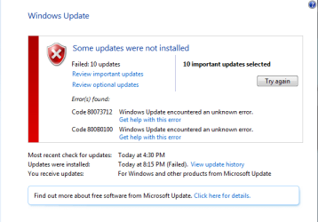

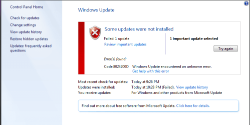

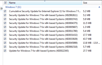

I built this computer around 2 or 3 years ago for a friend, he brought it back to me because he couldn't get 10 updates installed. I have tried the fixit repair and the SURT tool with no errors on completion of each. I have tried stopping the updating service and changing Software Distribution folder. any help would be appreciated. The CBS zip will not upload (Properties says it's 73.9 MB)

Please follow the Windows Update Posting Instructions and post the requested data
If the file is too large (8MB compressed), remove the older CBSPersist cab files until the final file is below the limit - you can always post them separately after zipping them. (the forum doesn't allow the upload of bare CAB files, for a number of reasons)
Please also post the C:\Windows\windowsudpate.log file

I've uploaded a file - wmtaa.zip - to my OneDrive at Noel's OneDrive
Please download and save it.
Right-click on the downloaded file, and select Extract all…
Extract to the default location - which will create a new folder wmtaa in the same place.
Open this folder - there should be two folders inside it (Manifests, and Packages)
Copy the content of the Packages folder to the folder
C:\Windows\Temp\CheckSur\Servicing\Packages
And the content of the manifests folder (.manifest files) into this folder:
C:\Windows\Temp\CheckSur\Winsxs\Manifests
Now run the CheckSUR tool again (it may take a while)
Post the new CheckSUR.log file, and the CheckSUR.persist.log file.

After last post I restarted the PC, then ran windows update again. All updates installed except 1 (KB2992611). got this error code....8024200D

THANK YOU VERY MUCH!!!
ALL is well now :party:
