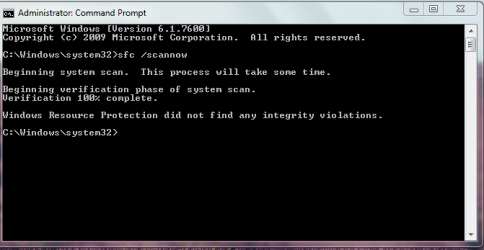

2. SFC/scannow said 'no errors to be fixed '

Now run SFC /SCANNOW in an Elevated Command Prompt
then reboot and upload the new CBS.log file to your reply

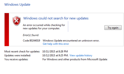

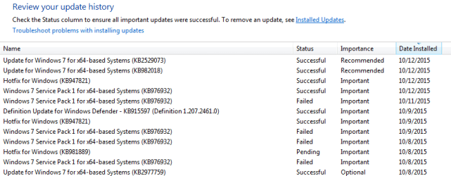

Windows Update Check gives Error 80244019. Attached Screenshot .

Hokay :(
Open Event Viewer
click on the Windows logs entry in the left pane to expand it.
Now click on the Application entry - wait while it loads.
Click on 'File' in the menu bar and select Save...
Save the file as Appevt.evtx
Repeat for the System log
then zip both, and upload them.

Done . Attached Appevt.evtx and System Log . What does this mean though .
What was earlier Issue , is that still exist ? Or this is new issue . I am bit confused -:( .

There don't appear to be any serious problems in the System log.
I see that you appear to have Office Click-to-Run installed - do you actually use that, as it appears to have some issues?
There are problems with a couple of other programs - Dell's Support Centre/PC Doctor, and Cozi Express.
I would try updating both of those - or uninstalling them if you don't use them
