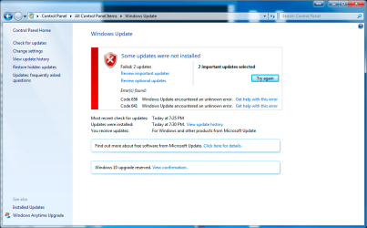

error installing .NET 4.5.2 windows installer service not available..
fatmann66
7:10 AM
9
ran windows update and received error code 656 and 641.
download .net 4.5.2 offline and received windows installer service not available.
verified that installer service did start when update kicked off.
unregistered and reregistered Msiexec.exe
ran windows update troubleshooter
reset Windows update (cleared .db etc.)

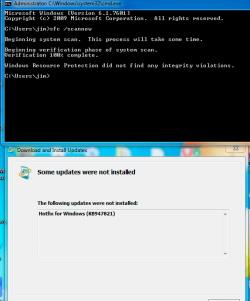

ran SFC-> came back clean
ran SRUT - > failed to install
see attached pic and logs.
-- could upload the whole CBS folder as it was 57mb zipped. attached the current cbs.log file
any help would be appreciated

Please post the CheckSUR.log and CheckSUR.Persist.log files.
Please downloadthe Farbar Service Scanner from
http://www.bleepingcomputer.com/download/farbar-service-scanner/
Right-click onthe saved file and select 'Run as Administrator', and tick all the options,then click on the Scan button - copy and paste the report to your response.

NoelDP,
is the checkSUR.log part of SRUT? if so, that won't install so I don't have that log
see attached Fabar log
I un-cabbed a cbspersist.log and got the size down to where it can be uploaded. see attached.

NoelDP,
any ideas?

The only anomaly in the Farbar is the following:
Firewall Disabled Policy:
[HKEY_LOCAL_MACHINE\SYSTEM\CurrentControlSet\Services\SharedAccess\Parameters\FirewallPolicy\StandardProfile]
"EnableFirewall"=DWORD:0
- do you have a third-party firewall installed? Which one, if so?

I had avira installed, but removed it a few days ago as part of troubleshooting this issue.

Avira isn't a firewall - it's an Anti-Virus ;)
Follow the instructions here to make sure that it's completely removed.
What AV is currently installed?

Correct Avira is A/V, but it also provides a software firewall that runs in place of the MS firewall. Mute point As I stated I uninstalled it a few days ago. currently no A/V is installed.

can't install security essentials RE: installer service issue and no .Net framework. reinstalled Avira and scan was clean.

MSE doesn't use the .Net framework 4.5.x at all.
The installer service issue could be a problem :(
Please open an Elevated Command Prompt, and run the following commands
ICACLS %TEMP%
ICACLS %TMP%
post the results.

Microsoft Windows [Version 6.1.7601]
Copyright (c) 2009 Microsoft Corporation.  All rights reserved.
C:\Windows\system32>ICACLS %TEMP%
C:\Users\user\AppData\Local\Temp NT AUTHORITY\SYSTEM:(I)(OI)(CI)(F)
                                BUILTIN\Administrators:(I)(OI)(CI)(F)
                                user-office\user:(I)(OI)(CI)(F)
Successfully processed 1 files; Failed processing 0 files
C:\Windows\system32>ICACLS %TMP%

That output is normal.
Let's have a look at the event logs...
Open Event Viewer
click on theWindows logs entry in the left pane to expand it.
Now click on theApplication entry - wait while it loads.
Click on 'File'in the menu bar and select Save...
Save the file asAppevt.evtx
Repeat for theSystem log
then zip both,and upload them.

see logs attached

The good news is that the number of errors has dropped dramatically since the uninstall/reinstall of Avira and .NET
The bad news is that I'm none the wiser :(

ok thanks. I guess I'm looking at a reinstall then.
