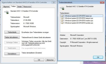

What SATA controller? Is this the onboard sata? Can you open up the device manager and display the sata controller information and post it here? When the drive is plugged in and working, can you display its device properties and post them here? The following is sorta what I am looking for for a start. I am assuming this is a SATA channel and not a SCSI one (like a jMicron or Marvell chipset). If it is the atter then post the SCSI device properties policcy tab.

you mean something like this? it's in German but I think the structure of the dialogues should be the same.

You are using the standard Microsoft AHCI drivers that apparently have a known problem detecting hot-plugged hard drives. I was going to suggest you use the AMD AHCI drivers but came across the thread linked below. This thread also discusses the failure of MS AHCI drivers to detect hard drives that are plugged in.
You can try the AMD drivers - you could always revert back to the Microsoft drivers if they are a problem.

i would really like to try the AMD driver, the problem is that windows just won't let me install them. I suppose the problem is the following:
The device class of the MS driver is "IDE ATA/ATAPI controllers" (Class GUID 4D36E96A-E325-11CE-BFC1-08002BE10318) and the class of the AMD AHCI SATA driver is "SCSI and RAID controllers" (Class GUID 4D36E97B-E325-11CE-BFC1-08002BE10318)
I'm not quite sure why this is the case. I wonder if it is possible to modify the *.inf file (AMD driver) or the registry (MS driver) to make them matching.
