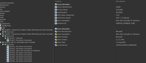

- The wheel is recognized in every single port as 360 pad (as originally intended for full analog support) but only the green light in the back is turned on, the red light in front (power?) is off, and in the gamepad control panel it inputs no signal at all.

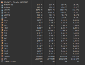

Ok Tir now one of the first things that comes to mind is that the build is like one of mine a Sandy Bridge and therefore getting on a bit and I am just wondering if the PSU may need a look at.
So take a look at this and post back please - as by the by just what board do you have in place - an Asus Z77-A could be a few models.
Using HW Info
PART A:
You can test the volts on the PSU with HW Info HWiNFO, HWiNFO32/64 - Download < download the right bit version and close the right hand window select Sensors and scroll down to the power section where you will see what the volts are doing see my pic. In my pic the section (Nuvoton) with VBATT as a dead give away you are in the section for the rail voltages. There are other section titles and one that pops up often is ITE (sometimes the usual one for Gigabyte boards)
Now the voltage on the different rails have to be within 5% =+/- of what is required or the machine will not work properly if at all.
Limits +/-
12v1 = 11.4 - 12 - 12.6v
12v2 = 11.4 - 12- 12.6v
5v = 4.75 – 5 - 5.25v
3.3v = 3.135 – 3 – 3.465v
-12v = -10.80 - -12 - -13.20v
+5VSB = 4.75 – 5 - 5.25v
The Power good signal voltage at pin 8 on the 24 pin plug (grey cable) should be the same as the 5v rail reading/s
See this for the rail voltage info
PSUs 101: A Detailed Look Into Power Supplies (Section 2.)
The original right hand window shows the machine running and is handy for that but for looking at the components in some detail close it and use the main left hand side panel

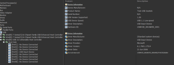

Thanks for all replies. I'll go in order. From HWInfo64 there's the picture

The board is just that, Z77-A. The pad shows failed enumeration in any hub, and no info.
