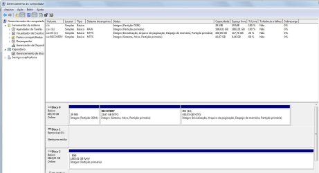

The reason I preferred generic is that in the original one, the usb port I used before, the hdd had its led blinking fast and computer stucked... had to power pc off in order to unplug hdd.

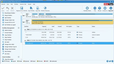

Screen shots shows hdd in other usb port, generic case.
It is a back up hdd, single partition. Don´t know why it came suddenly unaccessible. I was performing a back up, loading it and then... pc stucked.

Welcome to the forum. Raw means it's lost the partition table you need specific partition recovery software there are lots of free ones. Don't use file recovery all files will be there when partition is recovered. If one free one doesn't work try another as often one will work
win 8 32 bit
Welcome to Seven Forums.
Just checked your local time indicated is correct. Fine. You had fixed the correct Time zone.
From what I understand, you have taken out the HDD from the original case and have put it into another casing. Right?
The Disc 2 is the Toshiba HDD inside the generic case and shows RAW. Confirm.
What is Disc 1 which has a drive letter E but with no media ? Anyway you seem to have removed it while taking the Partition Wizard screenshot. That is good. Please remove all other external HDDs/Flash drives / card Readers while we are on this job. Have only the faulty drive plugged in.
About your new 2TB Seagate drive. Is it an internal HDD or external HDD? If it is an internal HDD, how do you propose to copy any data from the faulty HDD if we come to that?

Uninstall Partition Wizard version 10.2.2 and install Partition Wizard v 9.1. If we find that it is only a partition lost and need to do a Partition Recovery only the old version 9.1 can do it free. You can download and install v 9.1 from here MiniTool Partition Wizard Free 10.2.2 Download for Windows / Old Versions / FileHorse.com
Then post a screenshot of how your faulty drive looks in it.

samuria thank you very much, I've been reading and became somewhat familiar with Partition Wizard and TestDisk, but I humbly confess I'm afraid of doing wrong.
You see, I didn't notice that the updated version of P.Wizard (free ed) hasn't the functionality I needed...
That's why I will follow Jumanji's orientation. I'm a newbie!

PW9.1 installed, screenshot uploaded.
Toshiba hd went raw nearly 40 days ago; since then I've been reading (trying to understand) about many possibilities of what had happened and possible solutions.

OK, I have seen your screenshot. Since it was late yesterday night, I missed to note some important data. It is this.
Your faulty external drive does have a drive letter ( both in Windows Disk Management and Partition Wizard.) So it is quite unlikely to be a partition loss but a file system corruption. In any case, we shall run Partition Recovery Wizard and see what it shows.
Procedure:
1. Safely remove all external hdds/flash drives/ USB hubs/ Card Readers/USB connected printer- in short everything plugged into the USB ports except your USB keyboard and USB mouse.
2. Plug in only your generic external drive with the faulty Toshiba HDD inside.
3. Launch Partition Wizard. On the left Pane click on Partition Recovery Wizard > Next > Select your faulty Drive > Next > Full Disk > Next > QuickScan > Next. Allow the quick scan to complete. At the end of the quickscan you will get a window showing all the found partitions like the screenshot below. Post a screenshot of it ( only that Window. No need of any background). After you have taken the screenshot click on Cancel button on that Window and close PW. You can run it again if need be.

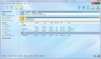

Everything done as you said, screenshot uploaded.
I'm amazed of how many diferent situations one can have... I noticed a letter assigned to my faulty hdd but, even reading a lot of cases in the web, I still find myself lost.
Being on my own, I certainly would not take the right step!
Comparing to your example screenshot I noticed that in my hdd, status shows 'existing' (rather than lost/deleted in yours) and guess what... I'm still lost...

Yes, As I said it is not a partition loss. The partition exists. That is why the status shows "existing".
