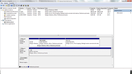

aalright i attached a pic just like you asked.
i tried connceting it to another pc but the results are the same.
it doesn't have an alternative way to be connected beside via usb.
oh and the pics language is Italian i hope it's not a big deal. It's the disk drive 1 , status online, primary partition.

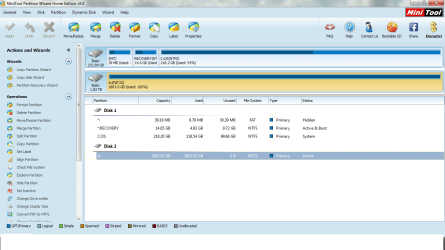

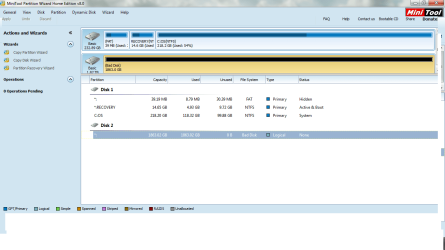

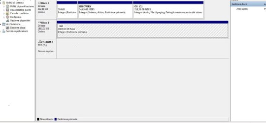

Same thing as i explained before.
As soon as i connect it to any pc it's displayed fine and i can access to its file (afor a couple of secs).
But then it's not recognized anymore and the various programs i used display it as bad( and its led stops blinking).
i tried to format its partition instead, but as soon as the partition wizard program access it , the same results happen.
it doesn't get formatted and it turns into bad state, can't be accessed anymore and its led stops blinking.
then i turn it off and on and its displayed as good again(look at my last pic)

Yes. Your ext. HDD looks fine in the second screenshot with FAT32 and 100% full.
Somehow it is alternating between good and bad state. And this happens in every PC as you aver. jumanji is stumped!
