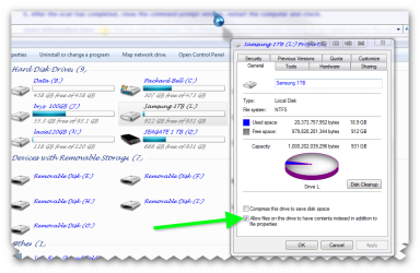

have you got the drives indexed?

@brian
yes, both hdd's have check...

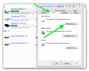

also run a check disk on the drives in admin mode you will have to re-boot

here's the result...
ok, i will check the cables also in cpu, but i dont think that would cause any problem. :confused:

run the check disk as well:)

also, i ignored the checkdisk (sry) hehe, it was so slow, coz of sata cables.
