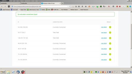

Success!

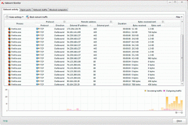

Finally I can run Cyberfox with no connections to Google ip addresses on startup. The single connection was due to setting https encrypted dot google dot com as home page. Even after opening a new (non google) tab and clearing cookies the connection persisted. Changing home page to something else resolved the issue.
Opened a new tab but no connection to Google ip's detected:

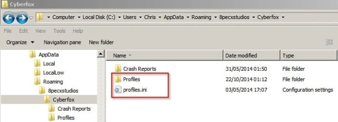

Edit:
I'd suggest backing up your Profiles folder and .ini file by copying them to another folder before trying any further modifications. That way you can restore your current profile if needed.

I know nothing about Kaspersky network monitor. Does it show the process path for the connection?

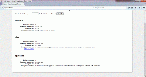

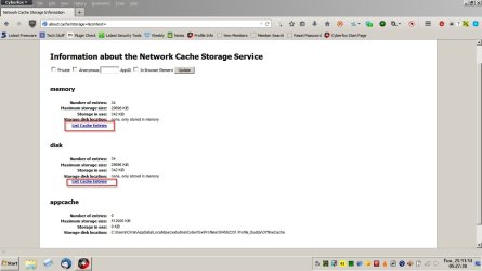

Check FF Cache
Well maybe try checking the cache to see if there are any entries there that give you a clue.
Type about:cache in the address bar and see what you find.

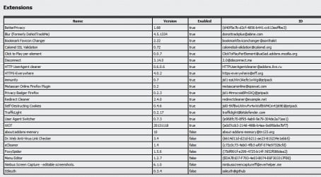

There could be other reasons why I don't see the same connection though. I'm using a lot of privacy enhancing add ons:

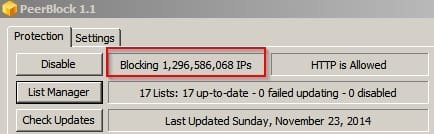

Along with a huge HOSTS file:
And a large IP address blocklist:
It's possible that one of the above blocks the connection but manually checking through that number of entries is probably impossible!

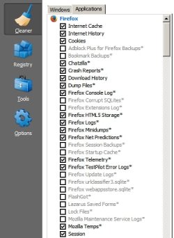

As for Ccleaner - I don't use the default settings and disk Cache is kept disabled entirely.
I think that I did notice that upon inspecting the cache it appeared that FF was making use of Google Embedded Fonts and blocked connection using my hosts file.

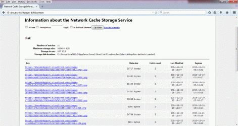

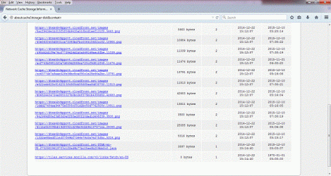

Maybe clean the cache then run Firefox and check the Firefox cache (about:cache) look at any new entries and try to find out if any of them could possibly be related to the ip addresses that you're concerned about. That's how I pinned down Google Embedded Fonts.
Thanks for helping.
I tried this method and here are the screenshots :

I've also disabled the Disk Cache as shown in your screenshot. Are you using CCEnhancer? I don't have all these firefox cleanup options that are in your CCleaner screenshot.
I tried the 'Hold down SHIFT key' trick and got the 'Start FF in Safe Mode' prompt, and still got the ips. But when I check the about:cache after Safe Mode there are no entries to list, all data is shown as 0 kb.
Yes I use CCEnhancer and also combine the winapp2.ini file with entries from other cleaners. That's not recommended for most users though!
I took a quick look at those cached URL's and it seems that you might be using the new FF version with "Tiles" enabled. If that's the case then whatever you see in those tiles is responsible.
Here's what I'd do to pin it down:
Disable Tiles: http://www.thewindowsclub.com/disable-remove-ad-tiles-from-firefox
List the ip addresses and block connection to them using either a Firewall or in my case Peerblock (or a combination of both). We are not really allowed to talk specifically about Peerblock on SevenForums as it is against the forum rules but in your case it could be used to create your own custom list of ip addresses to block.
You could also try adding the domains to your hosts file. I have numerous cloudfront dot net entries in mine.
Also see URL's listed here: https://bugzilla.mozilla.org/show_bug.cgi?id=1093297
Once blocked run Firefox and see if you notice any difference or have any issues with things not working correctly.
