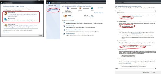

Also, make sure that you have the sharing settings below.

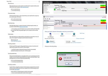

Thanks your help. Have followed your suggestions. See enclosed screen shots.
As you see I can ping the other computer 192.168.0.10 (WinXP) from the Win7 PC but can not ping the Win7 PC from the WinXP PC.
Regarding the file sharing settings they are as you suggested and are not changed when I go from a dynamic IP to a fixed one. Are there any settings I should change on the WinXP PC's? Maybe I am aiming at the wrong source of the the problem. However we have also a Mac on the network and all the WinXP PC's are accessable from the Mac with present WinXP settings

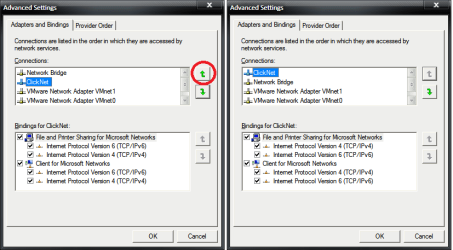

I might have figured it out.
On your Win7 PC:
Go to network and sharing center, click Change adapter settings (top left), press Alt (so you can access the menu), click Advanced, Advanced settings and move Local area connection 2 to the top of the list using the up button.
On your Win7 PC:
Local area connection 2 already at the top.

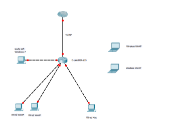

OK. Let's see if I got this right so far:
  1. When Win7 PC has 192.168.0.60 /24, everything works (file sharing, internet access, ping - all both ways)
  2. When Win7 PC has 192.168.0.20 /24, file sharing only works one way (can see shares but cannot share), internet access, ping only from PC7 to any PC-XP but not from any PC-XP to PC7.
  3. Basic network map looks like the picture below.

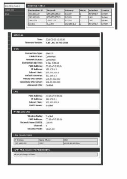

I'll have to see some configurations from your router:
  • Any Access Control Lists (ALCs)
  • All device interfaces (including WAN)
  • All firewall rules
  • DHCP server pools/settings
  • Any port forwading/virtual servers/DMZ/NAT settings
  • ARP tables (one with Win7 as 192.168.0.60, one with Win7 as 192.168.0.20 and one with Win7 as 192.168.0.20 after a router restart)
  • Routing tables/static routes/routing protocols.
What I don't need: passwords. Strip/blur them out.

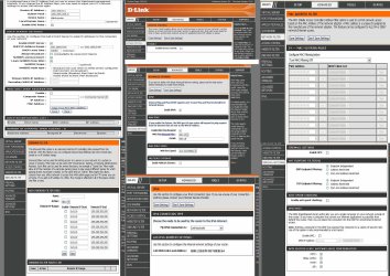

Enclosing screen shots from DIR-615

Just modify the DHCP pool to start from 192.168.0.20 and make a static binding for the Win7 PC.
To do that, edit the "DHCP IP Address Range" and set it to start from 192.168.0.20 to 192.168.0.99.
Check "Enable" in the Add/Edit DHCP Reservations, insert the Win7 PC name in the Computer Name field (WIN7), the IP that you want it to have (192.168.0.20) and the Win7 PC's MAC Address (e0cb4ee605e1) and click SAVE.
That way Win7 PC will always have the address 192.168.0.20 /24 reserved for your PC.
DHCP has up to 255 additional options that can be set and are probably required for a full conectivity so, I'm guessing it's a DHCP option (perhaps some NetBIOS setting) that's helping the Win7 PC with sharing or network discovery. (see DHCP codes and options if you want to learn more about DHCP codes).
And that's it. Set the Win7 PC to get an address via DHCP and it will always get the 192.168.0.20 one. You can also add other PCs there if you want more static bindings.
