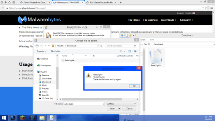

*Sigh...* How is my stupid computer not finding it when I'm sitting right here looking at it? And better yet, why is this thing not going away no matter what I do?!!!

I was referring to the blocked file.
Are you able to rename the file, or drag it to your desktop to hopefully be able to delete it afterwards?
I already stated in my first post that I was not able to do either. Absolutely nothing is working to get rid of it or alter it in any way.
