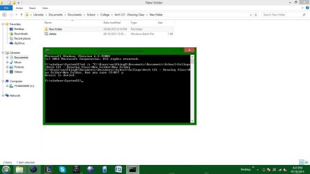

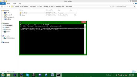

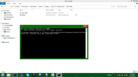

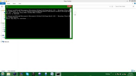

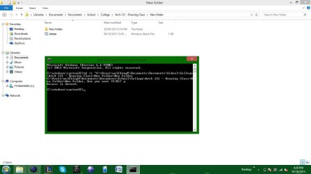

Well, this folder is extremely stubborn. Here is my process and sorry for the length of this post:
I tried deleting it first.
It failed.
I then tried using a command prompt to delete it.
That failed too.
I created a batch file; one that was recommended to someone with a similar issue to me.
This one did not work.
I decided to break out the big guns: the elevated command prompt.
Nope, still there.
What do?

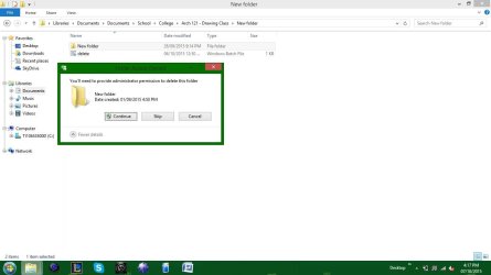

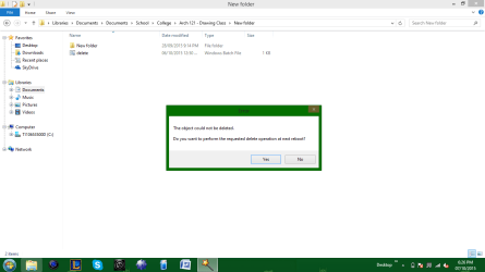

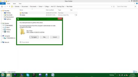

Hey guys, guess what.
Didn't work either.
Windows 8 64 bitAMD E2-1800 APU 1.7GHz4 GB (3.59 GB usable)Radeon HD graphics
Toshiba
Windows 8 64 bit
Unknown
Radeon HD graphics
Unknown
If you click on Yes in the second screenshot, does it delete it for you then?
Nope, still here after reboot.
