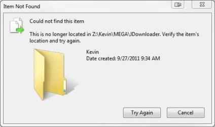

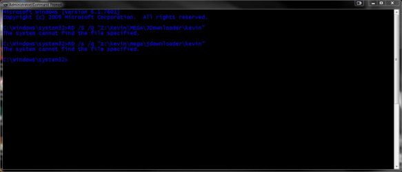

Need Help With Folder
This is the path of the folder I want to delete.
Z:\Kevin\MEGA\JDownloader\Kevin
I just tried this in Command Prompt and I get this message.
I have tried everything to delete this folder and nothing seems to work. I have tried Unlocker, LockHunter. This is the message I get when I try to right click and delete it.
I have also tried sfc/scannow and chkdsk and nothing. This is not the drive the OS is on.

Hello Kevin,
Did you also try deleting it from a command prompt at boot?

@Shawn Yes I did.
@Norp Didn't work.
I just went ahead and copied files to a different drive and then formatted the drive. Everything is good now.
