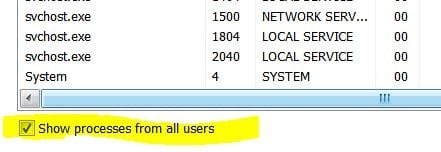

Is there a way to force Task Manager to open with the "Show processes from all users" option enabled?
I created a shortcut and added "/1" (without quotes) in the property target line but it did not work. (I know, one click will accomplish this but I just like to tweak!)
Disregard.
Found Brink's post of 05-18-2009 on same subject. Followed his directions and worked like a charm.
Thanks Brink !
