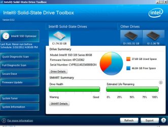

I don't have a direct answer to that, but I suspect the distinction between large and small files is largely irrelevant. What matters is how many times a given cell is written to.
In the last hour, I downloaded the newest version of Intel's SSD Toolbox---it's only for Intel brand drives.
It has an "estimated life remaining" feature, as shown below in the second green bar. Note that mine is still rated at 100% after 11 months of use. The help file says it declines linearly over time to 1 and that even at 1 the drive will still be usable. The 100% figure is based on a wear indicator found among the SMART attributes.
Given that, I just cannot get excited over "wearing out" an SSD--or any distinction between small and large files.
I'm sure you might be able to concoct an SSD usage pattern that might be a cause for concern, but not for anyone who is remotely like a typical user.
