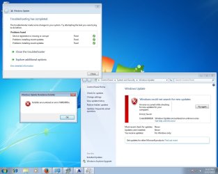

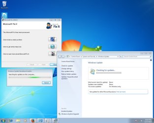

Performed a fresh Windows install on a new OCZ-TRION100 (SSD). Now, when I go to run Windows Update it stalls on "Checking for updates" message and never progresses. Most processes that use windows update are also failing. I have tried several different methods to fix this with no success yet.
I've cleared the SSD and freshly reinstalled Windows 7 more times than I can count in the pursuit of a fix. Each time I reinstall, I delete all partitions using the windows install disk interface. I run BIOS once the SSD is entirely un-allocated space. I attempted most of these fixes in either IDE or AHCI mode with varying results. Yet ultimately the problem persists.
I would post the Windows update error code, but since it never proceeds past "checking" and never stops "checking" unless stopped through CMD; I receive no legitimate error code or error message.

Ran the Update Readiness Tool. The first time I ran it; it installed the hotfix successfully. Rebooted, and it says "configuring updates" for a split second then appears to fail. It continues the reboot and does the same thing when starting.
After the reboot, the problem persists. Attempted running it again and now it stalls on "Searching for updates on this computer..." and never progresses further. Also, pressing the 'close' button does not respond.

Ran MC Fix It 50123, it created a system restore point, then appeared to have completed successfully. Didn't see any indication that it had actually done anything. Rebooted, yet problem persists...

Ran Windows Update troubleshooter successfully. Says all of the problems are fixed. Rebooted, yet problem persists...
