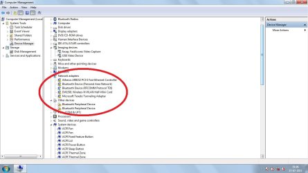

Hi guys,
It seems windows won't let me breath easy for long :cry:.
Problem description :
I am unable to connect to wired or wireless internet, reason being, I think, is because windows firewall is not starting.
Not sure why this happened but I think its because of a false flash update which might have been a rogue program, ( rootkit kindof though NOT sure ). Also let me tell you that, I frequently use utorrent to download movies, just in case if that might be the root cause.
After going through tons of posts I thought of starting this thread which, I hope turns out to be of genuine help to others as well.
System Specifications :
Dell Inspiron N4010
Windows 7 Home Premium ( 64 bit ) SP1
Antivirus : Microsoft Security Essentials ( nothing else )
Dual boot system along with Ubuntu ( which comes to my rescue time and again :p )
Tried the following solutions in the given order,
Solution 1 :
Tried starting the BFE and Windows firewall service manually using admin rights.
Result : Gave error code 0x8007042c
Solution 2 :
Tried running sfc scannow using admin rights.
Result : Please find attached the screenshot showing the output of sfc scannow & CBS.log file
Solution 3 :
Tried scanning the entire system using Microsoft Security Essentials.
Result : Didn't detect any viruses/malwares/worms/etc and said PC is protected.
Solution 4 :
Tried Balon's solution mentioned in this thread >> http://www.sevenforums.com/system-security/202166-unable-start-windows-firewall-2.html
Result : Still couldn't start BFE and firewall services.
Solution 5 :
Tried TDSSKiller
Result : It did not detect anything
Solution 6 :
Tried running McAfee's RootkitRemover utility
Solution 7 :
Tried scanning it using Microsoft Safety Scanner
Result : No issues found
Solution 8 :
Tried scanning using Malwarebytes' Anti-Malware
Result : Please find attached the mbam logs
Please note : I dont have internet access so I can't scan my PC with any tool/utility available online.
But I can download exe files and then install and scan my PC.
After the above failed attempts to resolve the issue I decided to finally seek expert help, since I don't want to format my PC once again. Also please bear with me if this turns out to be one of the dumbest of the issues.
But as of now looking forward to a quick and crisp solution.

Open up the Device Manager .
click on :orb: right click on Computer select Manage. If you get a User Access Control window click on the Yes button . Once Computer Management opens up click on Device Manager on the left hand side.
Do you have any :warn: symbols ?

Hi VistaKing,
Yes there are a lot of "!" symbols under Network Adapters.
Please find attached the screenshot showing the same.

There is your reason why you have no Internet . You would need to download the drivers for those items .
