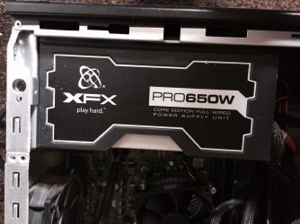

Many thanks for a quick reply, The PSU is a XFX 650W, so assuming that it is 650 watt, should I double check ?
Pic should be attached.
Swamps

Well that isn't much over head to power the rest of the system 750 would be a minimum but the prices for 850P2 evga are pretty cheap well worth the investment
I wouldn't go more than 400w gpu with that psu
Heck you can get a evga 980 card if you have the power to push it and yes kids will push/ push/ push it :p
If you wiring to that psu has removable connections you're all set to hook it up with a new
If not the case would have to be rewired :(
Show a new picture of the wiring to the psu

I guess this is the psu you have now,
XFX P1-650X-XXB9 650W ATX12V 2.2 & ESP12V 2.91 SLI Ready CrossFire Ready 80 PLUS BRONZE Certified Modular Active PFC Power Supply - Newegg.com
12volts to the main rail but it only is a single so just upgrading it to a 850P2 will be better it will have 2
Deal might be you need 2 power connections to the new card instead of just 1 that this 650 psu has.
