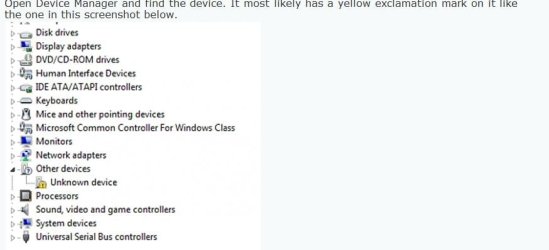

I know how to get into my device manager, but how do I know if there is a conflict?
