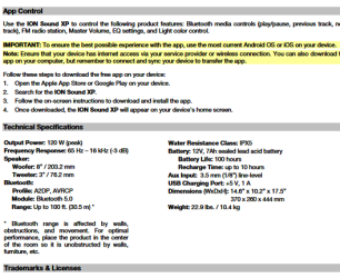

as this piece of kit is v5, according to this its not Natively supported on w7
https://www.google.com/url?sa=t&rct...ows-versions&usg=AOvVaw3KhMnoLMRNOuHlDUTNHdre
easy to check if its correct -- what versions are your others running

hi
i blew up the install device setup page to find the version
it also quotes andrios/ios requirements
i can only find references to w11 drivers
note check the dell page MIGHT have driver

hi
