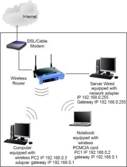

OK you can obtain the same result by using the actual manual server IP address as the default gateway.

aem - your wrong.... you can access files on a wired network wirelessly as long as the settings are correct.
Technically a network requires a minimun 2 pcs, If you have a server connected to a modem by wire, that to me is not a network. You may be on your ISP network but interms of your own home network, you haven't got one yet. So to be able to access your server ie connect to the shares on it, you need to connect/ping it. Right? How do you intend to do this? does your server broadcast it's IP wirelessly for your other devices to pick up?
So far we only have a server wired to the modem (i assume), and other devices which wants to connect to this server through wireless connections.

There is a network of 2 PCs connected to the broadcom router either wirelessly or wired.
the requirement is to connect a server to the existing network but to deny the server access to the network.
One example of a system that should work is this
Router IP 192.168.0.1
PC1 IP 192.168.0.2 gateway IP 192.168.0.1
PC2 IP 192.168.0.3 gateway IP 192.168.0.1
Server PC IP 192.168.0.255 Gateway IP 192.168.0.255
The two PCs may have their IP set by DHCP from the router as long as the server address is excluded from the DHCP pool

A picture is worth a thousand words. This according to Barman's instructions. Hope this helps to clarify any confusion. Just another $0.02
This is exactly what i am trying to get to.
The IPs of 192.168.x.x are part of the router's setup (Linksys IPs), they are not provided by your ISP. In other worlds, setup your router to enable DHCP, and allow your machines to auto detect IPs and you will have 192.168.x.x in your ipconfig details.
With a wireless router broadcasting the network, everything falls into place. As for restricting the server to again access to the internet. Many ways to do this, but i don't see the need to do this, why would you?
Ps I have only used static IP in a peer-to-peer networking between two PCs (with crossover cables).
