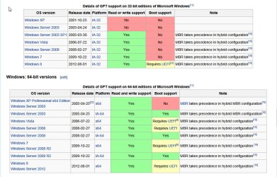

jumanji, Win8 -> GPT -> NTFS and Win7 -> MBR -> NTFS; one cannot "miss-match" GPT & MBR w/OS, correct?
