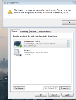

My PC won't output any sound over HDMI.
-I've tested all the cables. They all work fine.
-I plugged a laptop into the HDMI socket (on the amp) that i use for the desktop. Sound is carried fine.
-There's no error messages in Device Manager, it says the driver is installed fine.
-HDMI output is set as the default.
-I even replaced the HDMI card, just in case.
At this point, it seems like i am doing something very silly, or there is a particular fault with the slot on the motherboard?
However, i ran the motherboard's diagnostic program, it told me there are no issues.
I'm stuck.
Can anyone help?
Thanks

Hello KifCroker, welcome to the Forum
Play some audio on the computer and then open up the Volume Mixer to see where the sound is going.
To Open the V|olume Mixer, right-mouse click on the Sound icon on the bottom right corner of the display. Select Open Volume Mixer from the list.
Volume Mixer will show the Sound levels on different Devices and Applications.

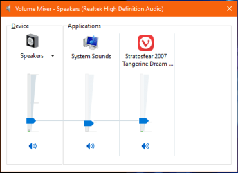

Play some audio on the computer, then press Windows key + R, type sndvol into the box, press Enter.
Take a screen shot of the pop up window, which should look something like this: volume mixer.PNG
2) Run the Sound Troubleshooter, and see what errors it reports.

I fixed it, it was a combination of needing to roll back the driver, and fussy settings on my amp.
Thank you for patience, all of you.
