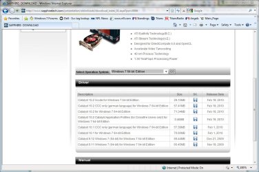

Maybe it is my broadband connection but the driver download is saying 5 hours remaining:confused:
OMG!!!!!!!!!!!
The 71 MB file???

I'm assuming I'm downloading the correct file from the Sapphire website page:
Catalyst 10.2 for Windows 7 64-bit Edition 71.34MB

Should be... any luck in the speed?

Interestingly I've installed the Windows XP 32-bit ATi Cat 10.2 driver from the Sapphire website and booted into Windows XP (on my other hard drive) and the problem is the same. I still get specs/dots and some horizontal lines, just the same as I did on my other drive (OCZ Vertex SSD) in Windows 7 64-bit.
