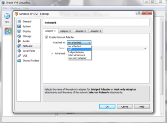

im new with VirtualBox , i got VirtualBox running in my laptop with windows 7 and is connected to my wifi router ..
and yes the internet of my pc is working.
now i already installed windows Xp in Virtualbox but my problem is that windows xp is not connecting to the internet :(
since i have wireless internet and not Cable internet i dont know the right settings on how to set this up to make it work.
any help will be appreciated

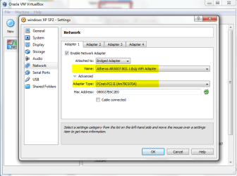

Select Bridged or NAT. Both allow you to connect virtual machine to Internet, Bridged is better for networking and sharing between virtual machine and the rest of your network (host and other computers in network).

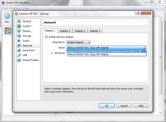

Select your host computer's WiFi adapter (Atheros in your case) from drop down list.
Click Advanced, choose one of the two PCnet adapters.
Should work now.

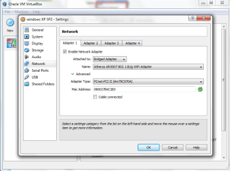

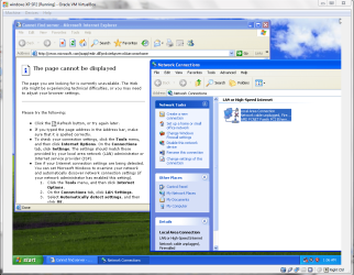

thanks for replying / helping me out with my problem , sorry about the orange font i have put it back to normal.
I have set all the settings just like you told me to and im still not getting a internet connection.

OK, back to the topic. I can see from your second screenshot that you have not installed VirtualBox Guest Additions. It's essential to install them, so please do it now.

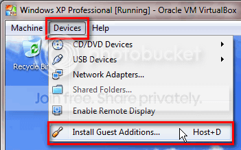

  • Open Devices menu in virtual machine's menu bar. Select Install Guest Additions:

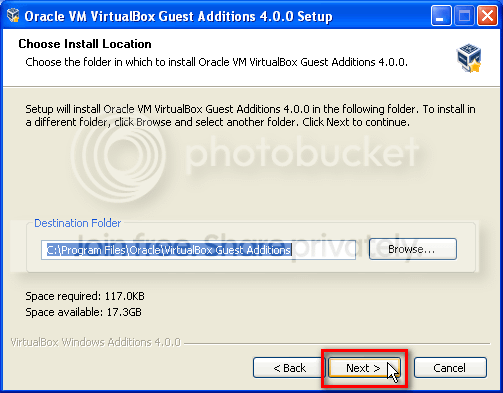

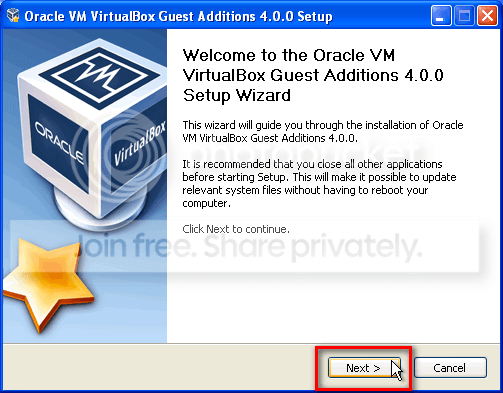

  • Click Next in following two windows:

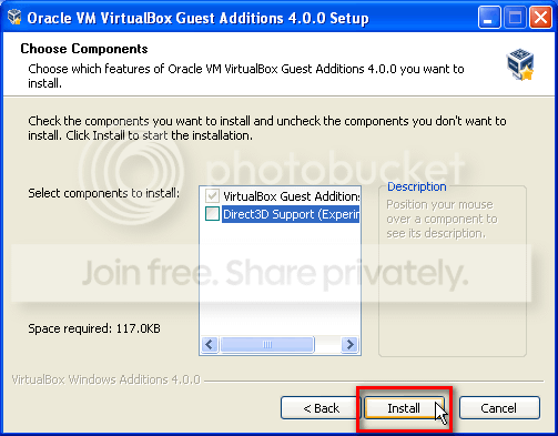

  • Click Install:

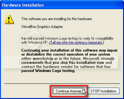

  • When XP warns you about not known device driver (two or three times during installation), click Continue Anyway:

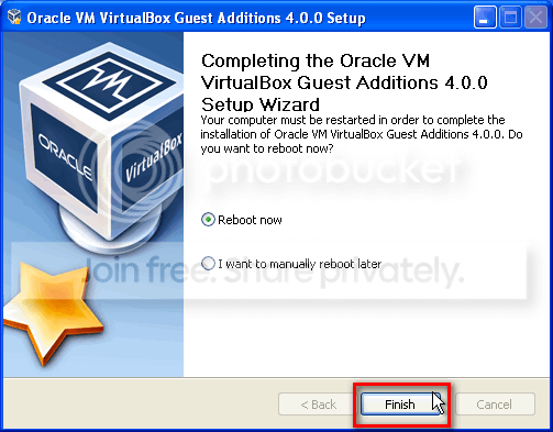

  • Click Finish to end installation and reboot XP:

Check that you have correctly selected your host machine's network adapter, the one you use to connect to the network:
Try changing the adapter type. If all settings are correct you should be able to connect.

So I know that my computer uses the ASUS 802.11n Wireless LAN to connect to the internet, so I used this to begin with. But, still no connectivity. So I tried all three of the options below and also decided to check my device manager and I found this...
Is this supposed to be there? The Virtualbox Host-Only Ethernet Adapter?
I tried all combinations of the 3 Bridge Adapter names with all of the Adapter Types, but still no connectivity? I did get this:
When I changed the adapter to the the Intel(R) Pro/1000MT selected ad the Adapter Type, but as you can see, there's still no connectivity.
